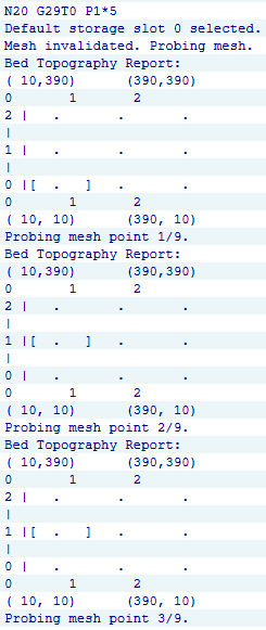

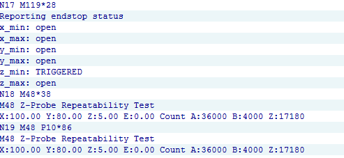

Ребята прошивался я на Марлин 2.0 пробую настроить выравнивания стола по Unified Bed Leveling (UBL).
В качестве дачика Блин точ
после команды M48 P4 V2 E L2
Но сопло после команды G29 P1:
все остальное кроме выравнивания работает.
КОД :

- //#define Z_MIN_PROBE_ENDSTOP_INVERTING false // Set to true to invert the logic of the probe.
- #define ENDSTOP_NOISE_THRESHOLD 3
- #define Z_MIN_PROBE_USES_Z_MIN_ENDSTOP_PIN
- #define FIX_MOUNTED_PROBE
- #define NOZZLE_TO_PROBE_OFFSET { 0, 20, 0 }
- #define XY_PROBE_SPEED 1000
- #define Z_PROBE_SPEED_FAST HOMING_FEEDRATE_Z
- #define Z_PROBE_SPEED_SLOW (Z_PROBE_SPEED_FAST / 2)
- #define MULTIPLE_PROBING 3
- #define Z_CLEARANCE_DEPLOY_PROBE 5 // Z Clearance for Deploy/Stow
- #define Z_CLEARANCE_BETWEEN_PROBES 10 // Z Clearance between probe points
- #define Z_CLEARANCE_MULTI_PROBE 5 // Z Clearance between multiple probes
- #define Z_AFTER_PROBING 10 // Z position after probing is done
- #define Z_PROBE_LOW_POINT -5 // Farthest distance below the trigger-point to go before stopping
- #define Z_PROBE_OFFSET_RANGE_MIN -3
- #define Z_PROBE_OFFSET_RANGE_MAX 2
- #define Z_MIN_PROBE_REPEATABILITY_TEST

- #define AUTO_BED_LEVELING_UBL
- #define RESTORE_LEVELING_AFTER_G28
- #define DEBUG_LEVELING_FEATURE
- #define SEGMENT_LEVELED_MOVES
- #define MESH_INSET 10 // Set Mesh bounds as an inset region of the bed
- #define GRID_MAX_POINTS_X 3 // Don't use more than 15 points per axis, implementation limited.
- #define GRID_MAX_POINTS_Y GRID_MAX_POINTS_X
- #define UBL_MESH_EDIT_MOVES_Z // Sophisticated users prefer no movement of nozzle
- #define UBL_SAVE_ACTIVE_ON_M500
- #define LEVELED_SEGMENT_LENGTH 1.0
