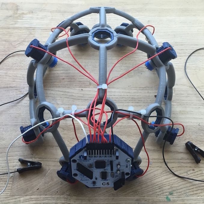

Требуется напечатать все детали по ссылке https://github.com/OpenBCI/Ultracortex/tree/master/Mark_3#3d-printed-parts
Настройки и материалы, предлагаемые автором:
FRAME_FRONT & FRAME_BACK
Material: PLA
Supports: YES
Raft: hopefully NO (but if supports aren't sticking, try the raft)
Infill: 20%
Layer Height: 0.2mm
Number of Shells: 3
Speed while extruding: 50-70% (slow it down if possible; these parts are detailed)
MECH_PARTS (OCTANUT / BOLT / SPRING_CASING / ELECTRODE_HOLDER)
Material: PLA
Supports: NO
Raft: NO
Infill: 20%
Layer Height: 0.2mm
Number of Shells: 3
BOARD_MOUNT, BOARD_COVER_STANDARD, & BOARD_COVER_ADVANCED
Material: PLA
Supports: NO
Raft: NO
Infill: 20%
Layer Height: 0.2mm
Number of Shells: 3
Material: PLA
Supports: YES
Infill: 20%
Layer Height: 0.2mm
Number of Shells: 3
Material: PLA
Supports: NO
Raft: NO
Infill: 20%
Layer Height: 0.2mm
Number of Shells: 3
Material: PLA
Supports: NO
Raft: NO
Infill: 20%
Layer Height: 0.2mm
Number of Shells: 3
